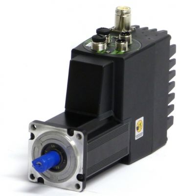

Designed for battery powered and low voltage applications the MAC402 is now available from JVL. The MAC402 is the VDC version of the popular MAC400 400W integrated servomotor. The supply range for the MAC402 is from 12 VDC up to 48 VDC, and full power of 400 W (RMS) up to 1200 W (peak) can be reached with 24 to 48 VDC. This powerful, compact motor measures just 191 mm (7.52 in.) x 60 mm (2.36 in) x 114 mm (4.49 in.) Applications include but are not limited to: Remotely operated robots, robotic vehicles, portable equipment, tracking devices, antenna mounts, and positioning devices.
Only JVL presently offers a 400 W continuous (1200 W peak) integrated servomotor in the supply range of 24 - 48 VDC operating at 0 to 3000 rpm. In many applications it is not necessary to choose a 750 W or larger motor as the 400 W (1200 W peak) motor will be sufficient, thereby reducing cost and saving space. MAC402 options include: Brake, absolute multi turn encoder, and planetary & cycloidal gearheads.
A wide selection of communication modules is available for MAC402 motors including: basic modules for pulse-direction (or analog input) or fieldbus modules including Profibus, Devicenet and CANopen, or programmable modules with easy connections to local sensors make integration into new and existing applications easy. Moreover, a wide variety of industrial Ethernet options are available: EtherCAT, EtherNet/IP, Profinet, Powerlink, Modbus TCP and Sercos III.  With the VDC supply option the advantages of the MAC400 VAC servos have been expanded to include applications for battery and low voltage operation, from 12 to 48 VDC. With wireless options like WLAN/Wifi, Zigbee or Bluetooth, the MAC402 MAC motor can run completely wireless.
A big advantage of using an integrated MAC motor is that there is no need for a separate servo driver/controller. The advantages are: Space savings in the control cabinet, eliminating expensive motor and encoder cables, RFI/EFI noise is minimized due to internal cabling, and connection errors between driver and motor are eliminated.  Additionally, service is much easier as the motor and controller are replaced as a single integrated unit minimizing downtime and maximizing production.
