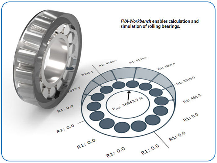

FVA-Workbench enables calculation and simulation of rolling bearings.

In practice, precise statements regarding losses in the drive are required as early as the project planning phase. Every bearing and every auxiliary drive counts. With the new statements from FVA 701 I and III, manufacturers can now provide these statements and prove them with investigations from joint research. The FVA-Workbench supports engineers with an easy-to-use calculation model, comprehensive input consistency checks, and easy-to-interpret results. With the results from FVA 701 II, gearbox manufacturers are now able to provide reliable statements regarding losses in the offer phase and better describe the loss mechanisms.
Evaluation of bearing losses with theFVA-Workbench
