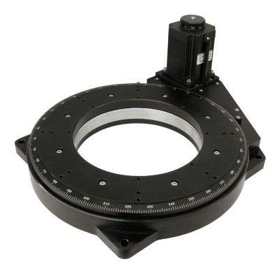

Intellidrives ServoBelt Rotary Stage offers an economical solution for a variety of light and medium-duty rotary motion applications. It features large clear aperture of 150 mm and provides arc-second resolution when driven from a micro-stepping or brush-less servomotor controller.
The low profile design is made possible by the use of compact precision bearing. The rotating carriage of the stage provides unlimited motorized rotation angle of the load up to 50 kg and has large clear aperture to allow the passage of the optical path or cables directly through the stage.
The main body of the stage is made from lightweight anodized aluminum and can attach directly to an optical table or moving linear or XY actuators and can be mounted at any orientation. The ServoBelt Stage uses belt drive to achieve high rotating speed.
