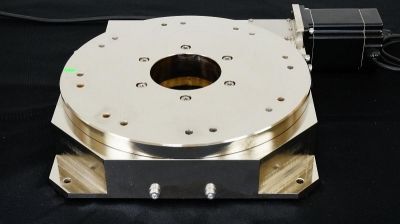

Motorized rotary tables RTLA-100-350HJ from Intellidrives feature IP65-rated ingress protection. IP65 rating assures against ingress of dust and water jets against the rotary table surface. The hollow shaft table is integrated with a high rigidity cross-roller bearing. This structure improves permissible thrust load and moment load while maintaining high torque. The large diameter hollow aperture (through-hole) helps reduce the complexity of wiring and piping, thus simplifying equipment design. Equipment tables and arms can be installed directly on the output table. This rotary table can be motorized with stepper or brush-less servo motors with encoders and matching drives and controllers.
