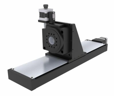

The Intellidrives BSMA-140H is a compact, high-performance linear positioning stage that is perfect for the confines of the laboratory while providing the high reliability required in a production environment. It is the ideal choice for measurement, testing, accurate alignment and component assembly. The precision ball-screw provides accuracy, repeatability and positioning resolution capability to 1 micron. The linear ball bearings provide smooth travel and excellent payload characteristics. The RTLA-30-100 rotary stages incorporate a precision worm-gear drive mechanism and bearing components for accurate positioning performance over the lifetime of the product.
Compact in size, with only 100 x 100 mm footprint, RTLA-30-100 has center aperture 30 mm and low profile 45 mm. Choices of worm gear ratios 180:1, 90:1, 45:1 are available to achieve range of rotation speeds and translated resolution of 1.8 arc-sec. Stages can be fitted with stepper motor, brushless servomotor with rotary encoder or integrated SMART motors.
