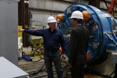

The 2.5-megawatt dynamometer facility: After connecting it to the dynamometer, researchers tested the drivetrain in realistic operational conditions to validate design tools and increase the technical readiness of the innovations.
The controllable grid interface:Unique to the National Wind Technology Center, the controllable grid interface allowed researchers to simulate real-time changes in the utility grid in a controlled environment, giving them a better understanding of how the drivetrain technology will react to grid disturbances. Keller describes the new drivetrain system as a “technology testbed” that uses sophisticated hardware and software that can be incorporated into different gearboxes, converters and wind turbines. These components include a:
