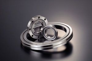

In addition, IKO designs and manufactures a wide range of crossed roller bearings that can handle radial, thrust and moment loads at the same time in compact sectional dimensions. These crossed roller bearings have rollers alternately crossed at right angles between inseparable inner and outer rings. Because the rollers in these bearings make line contact with the raceway surfaces, there’s minimal elastic deformation under load. Compared to ball type bearings, line contact of crossed roller bearings achieve higher dumping characteristics with zero or minimum preloading (T1) and more durability with anti-fretting feature under vibration of the machine. IKO International will be at Booth #E-134333 during IMTS 2018.
