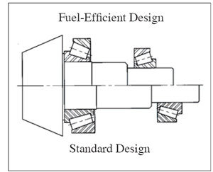

Figure 1—The Fuel-Efficient Bearing Design Reduces the Axle Size and Weight.

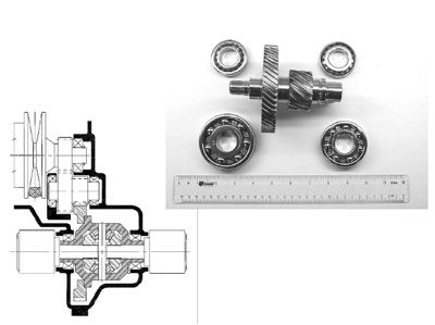

Figure 2—CVT Transfer Shaft Bearing Positions.

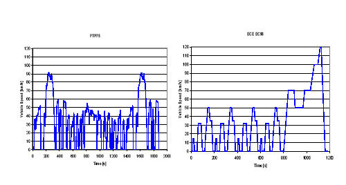

An important aspect for accurate results is correctly defining the operating conditions used for the design optimization exercise. This was done under the consideration of typical driving behaviors and of a fuel economy cycle (FEC) (Fig. 3).
Figure 3—FTP75 and ECE EC96 Fuel Economy Cycles.
For an axle application, the vehicle speed/time chart describing the FEC was converted into a diagram specifying the cycle percentage driven at a certain pinion gear speed range, and into a diagram depicting the relative energy lost by a unit of torque. The analysis showed that higher speeds bring the most significant contribution to the energy loss over the FEC. Accordingly, the design optimization will target the parameters directly involved with the high-speed torque reduction.

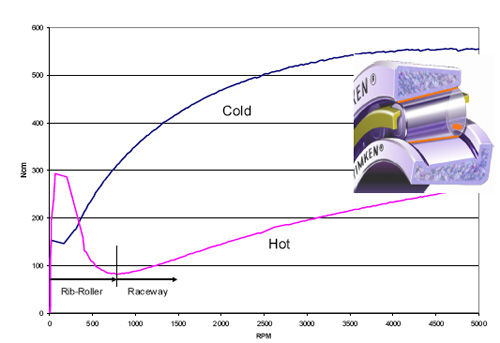

The typical torque behavior of a tapered roller bearing is shown in Fig. 4. At relatively low speeds, the rib-roller torque dominates, while at higher speeds, the roller raceway contact generates a higher torque contribution.

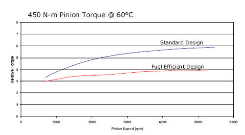

In addition to torque behavior—based on the specific durability, stiffness and efficiency targets—the fuel-efficient bearing arrangement also offers the opportunity for axle housing weight and size reduction (Fig.1). This design was tested under various speeds, pinion torque and temperature conditions while compared to the standard design (Fig. 5). The test fixture is presented in Fig. 6.
Figure 5—Pinion Bearing Torque Test Standard Design vs. Fuel Efficient Design.

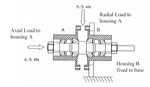

Figure 6—Pinion Simulation Test Arrangement.
In general, the fuel-efficient bearings yielded 30 percent lower torque values over the entire speed range in a clean oil environment. At 2,500 rpm and 60 degrees Celsius, this represents a 0.33 kW power loss reduction.

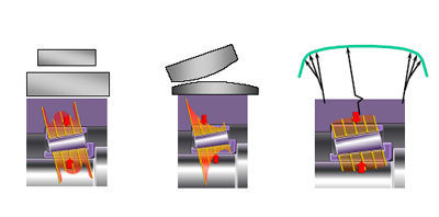

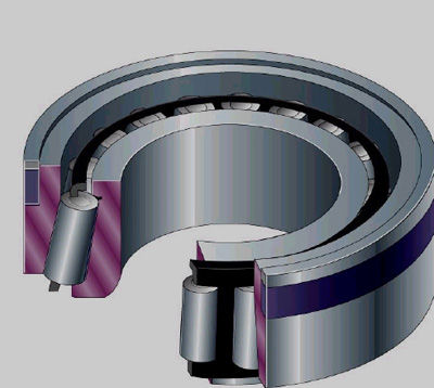

Applied consistently, these design principles lead to significant reduction in bearing envelope dimensions and to the concept of “bearing in a bearing” (Fig. 7). The small bearing can carry the same amount of load as the large one, but can fit into its bore. Such design modifications allow smaller bearings to deliver an equal amount of power but with more efficiency.
Figure 7—Bearing-in-a-Bearing Concept.

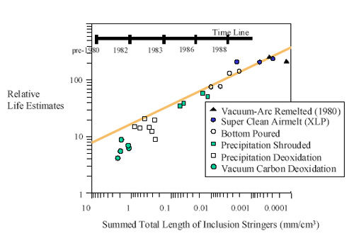

In order to deliver superior results, it is critical that bearings are made from the highest grade materials to meet the increased demand for power density. To help explain this importance, the evolution of the Timken steel cleanliness compared to relative life estimates is shown in Fig. 8. By utilizing advanced manufacturing processes, the summed total length of inclusion stringers was reduced by several orders of magnitude.
Figure 8—Timken Steel Cleanliness Constant Improvement.
Progress continues to be made in profiling the bearing races in order to improve the stress distribution (Fig. 9)—another important piece of the power density pie.
Figure 9—Bearing Race Profile for Improved Stress Distribution.

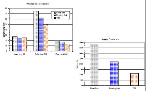

TRB Selection and Design Optimization for a CVT Transfer Shaft Application. The commercially available CVT utilizes a fixed and a floating ball bearing to support the transfer shaft. Using fatigue life and rolling torque criteria as a guide, a TRB design was refined to result in an optimum TRB design for maximum efficiency. A comparison between the dimensional characteristics and the weight of the ball bearings and of the proposed tapered roller bearings is shown in Figure 10.
Figure 10—Package Size and Weight Comparison between the Fixed and Floating Ball Bearings and the TRBs.

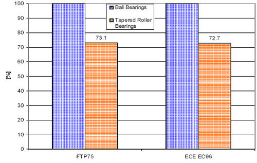

The impact of these torque characteristics on the total power loss over the two representative fuel economy cycles is shown in Figure 12.
Figure 12—Relative Power Loss Performance over a FE Cycle (approx. 27% powerloss reduction by using the Efficent New Design TRBs).
