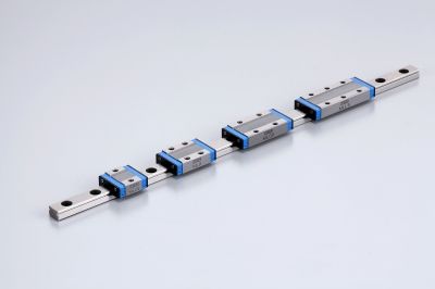

IKO's standard miniature bearings line is now available in rail widths from 1 mm to 25 mm with wide-bearing options as high as 42 mm. They are also available in up to four different lengths—compact, standard, long and extra-long in many sizes.
The variety of widths and bearing lengths enables designers to easily tailor a miniature bearing system to specific payload requirements. IKO's largest miniature linear bearings with the larger bearing lengths can handle much higher dynamic and moment loads than expected from a miniature unit. The largest miniature models for example, have dynamic load ratings in excess of 16,600 N (LWLG25) and moment load ratings over 320 N•m (MLFG42) in the roll axis.
To ensure its miniature bearings keep running smoothly, IKO has integrated its C-Lube long-term lubrication system into many units, which offers a controlled release of lubricant over 20,000 km of operation. C-Lube technology can be integrated into bearings as small as 3 mm wide.
