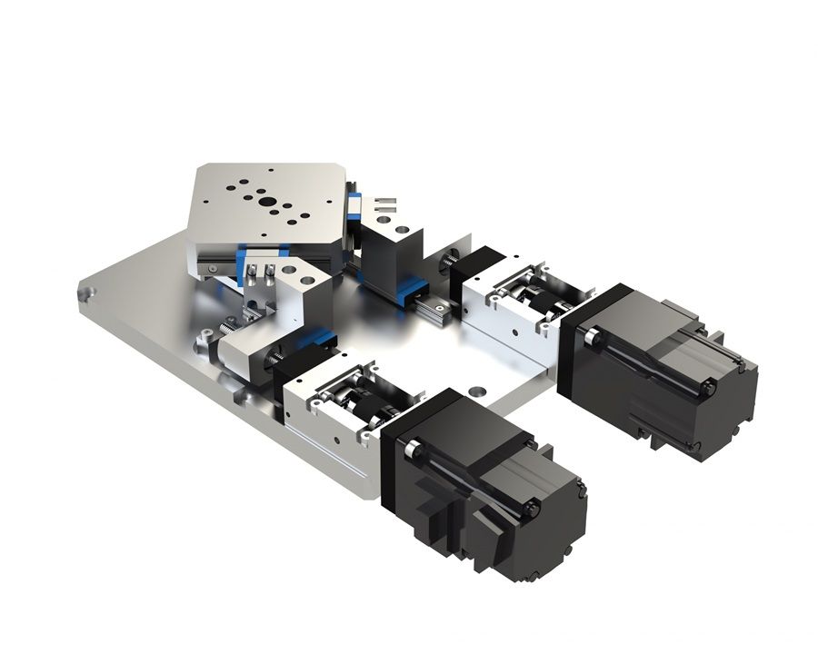

IKO International has introduced the PD…S X-Y parallel drive stage that removes the barriers that often exist in the work area during equipment design. With the PD…S, machine designers can achieve highly accurate positioning without sacrificing workability and performance.
Unlike typical X-Y stages layered with one-shaft actuators that make access from the outside difficult due to cables and moving motors close to the stage, the PD…S is designed with a mechanism that converts the ball screw actuator’s linear motion into X-Y motion via two parallel shafts. With two motors arranged in one direction, the PD…S creates an open, accessible work area for easy, flexible designs and customizations — all in a lightweight, compact unit with low sectional height.
Along with X-Y motion, the stage can also provide diagonal and circular motion. Precision is assured for every operation thanks to the PD…S’s integrated maintenance-free IKO C-Lube ML Linear Motion Rolling Guide. In addition, the PS…S also offers these benefits:
Motors stay in a fixed position as the table operates.
No extra space is necessary to prevent interference.
No additional wiring or cable carriers are required.
Durable construction ensures reliable operation.
