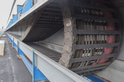

The world’s longest energy chain, which was manufactured by Igus, recently completed a decade of uninterrupted service at a coal power station in the Czech Republic.
The chain, which measures 615 meters, conveys coal to a stacker from the periphery of a power station operated by the CEZ Group in the city of Tušimice. The coal is stockpiled in a long heap, and the long e-chain supplies the stacker with energy, data, and media. igus, the Germany-based manufacturer of motion plastics, runs its North American operations out of Providence, R.I.
The application in Tušimice was awarded the golden vector award in 2010. Every two years, igus initiates the competition to recognize the most innovative energy chain applications. Ten years later, this system continues to work reliably and displays plenty of life, and sometimes even runs on a 24/7 production schedule.
Energy Chain Includes Rollers
The Tušimice power station project was managed by Hennlich, a stocking distributor for igus based in the Czech Republic. A 5050RHD energy chain is used in the system, and the 'R' in the name stands for “rollers.”
"By using a roller, the coefficient of friction on long travels drops dramatically, when the upper run of the chain runs on the lower run," said Frank Schlögel, head of engineering projects, sales and marketing at Igus. "Because of the lower friction, up to 57 percent of the required drive energy can be saved. Which, of course, is all the more worthwhile on record-breaking travels like this one."

A cable drum served as the conveyance source before the igus energy chain system was installed at Tušimice. During cold Czech winters, the cables froze frequently, resulting in failures and unplanned shutdowns.
Work stoppages related to those issues have discontinued since the installation of the igus e-chain. Working with Hennlich, igus developed a complete package for the application. Since then, regular visual inspections have been implemented and just 10 crossbars have been replaced.
Two more systems in the plant also feature roller energy chains from igus. One chain travels 400 meters, and the other traverses 150 meters. The two systems supply the “reclaimer,”  which removes the coal from the pile and transfers it to the conveyor belt that runs to the power plant.
