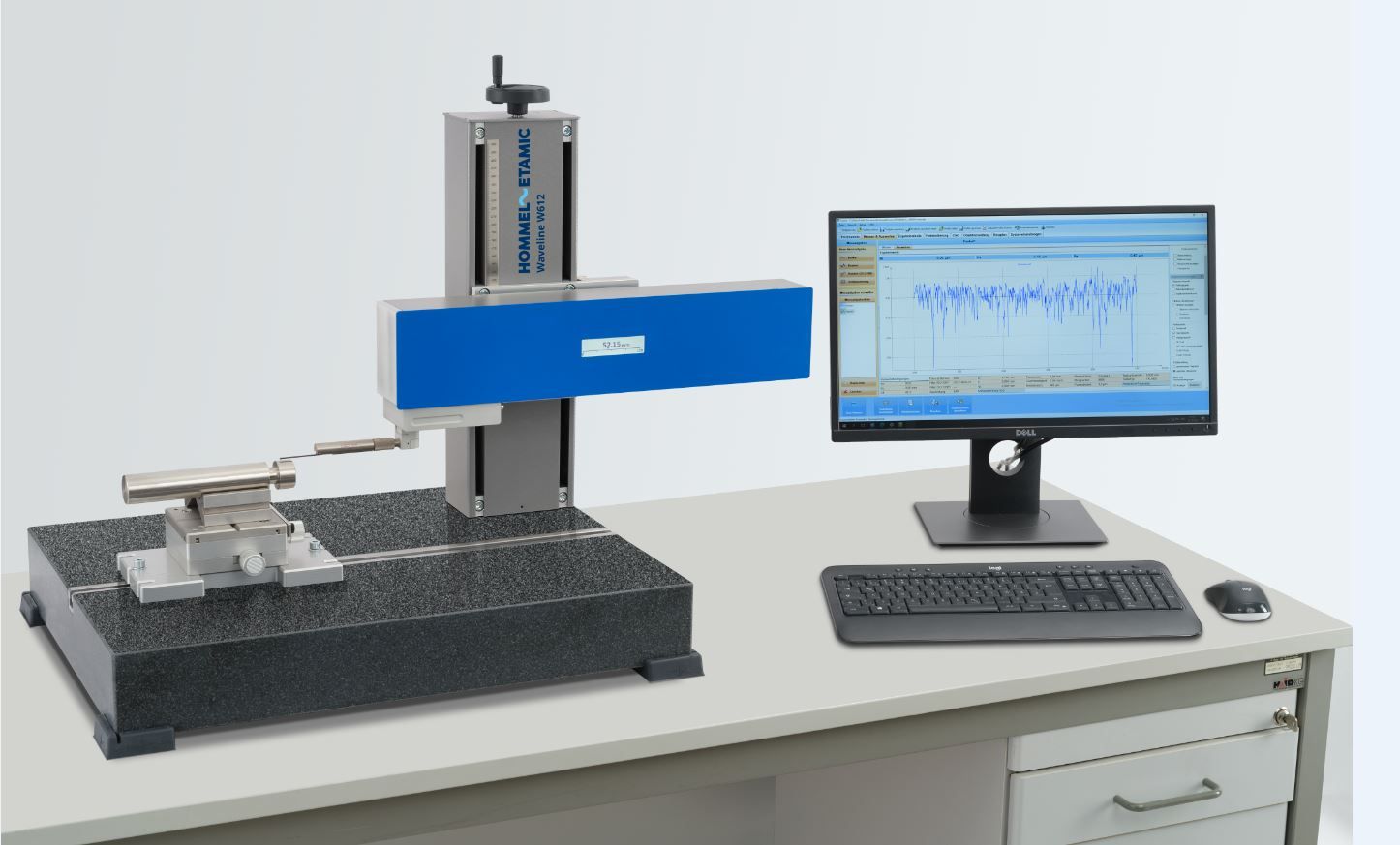

The new W612 measuring station features a Modular probe and system software with the capability to measure a resolution of 1nm with a TKU400 probing system. All Digiscan probe arms utilize a magnetically attached kinematic mounted coupling that enables quick probe system changeover with minimum retooling time due to automatic probe recognition. The Digiscan probe arms are equipped with an RFID chip for simple calibration and automatic configuration.
The system is modular in design with manual height adjustment for precise probe positioning. Modular design enables the upgradation of the roughness measurement system to contour measurement at any later time. The 120mm traverse unit will move at a speed of 20mm/s increasing operator productivity. The unit can either be adapted to mount on an existing customer granite base or can be equipped with a new one.
Measuring and evaluation Evovis software offers a standardized user interface with easy-to-understand control logic and extensive support functions for tailoring individual measurement applications.
