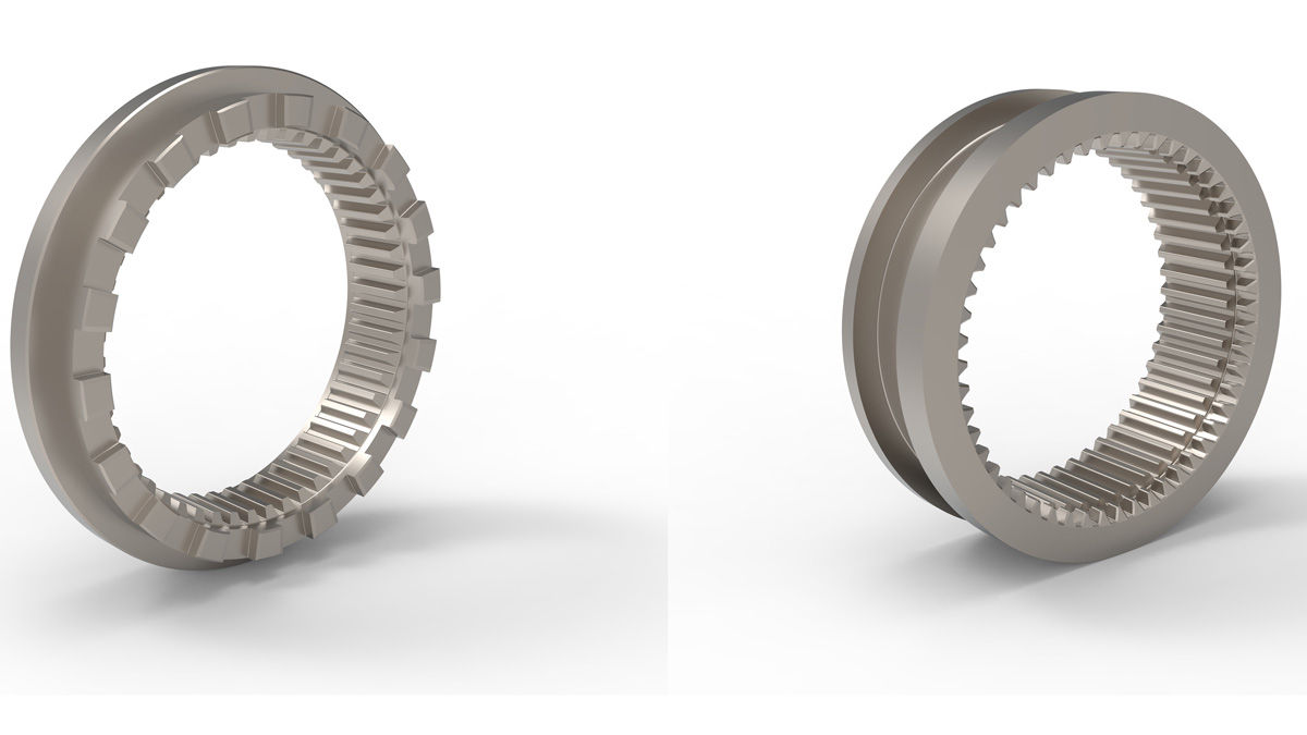

The primary function of an e-axle disconnecting system is to improve the efficiency and performance of battery electric vehicles by automatically decoupling the transmission shaft from the wheels when no power is required from the electric motor. As soon as power is required, the connection is closed again. Various concepts for disconnect units are available on the market, utilizing shifting components such as dog clutches or sliding sleeves to achieve the mechanical disconnecting function.

The powder metallurgy process is known for its ability to efficiently produce high volume parts with comparatively low energy consumption. The following chart (Fig.2) gives an overview of all possible process steps. Low loaded parts can have a process route that ends directly after sintering, whereas highly loaded parts such as disconnect sleeves require additional operations like sizing or heat treatment.
