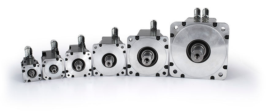

Kollmorgen’s AKM2G servo motor is designed to deliver higher power and torque density in a smaller footprint so OEMs can substantially increase performance without changing motor mounting or using more machine space. (Photo courtesy Kollmorgen)
