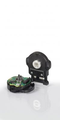

Heidenhain Renco Encoders Possess Modular Design Without an Integral Bearing
Heidenhain’s Renco brand of encoders is available for use within a variety of mobile robot applications. Specifically, the modular Remco R35i and RCML15 rotary encoders are designed for motion and speed feedback control in automated guided vehicle (AGV) projects used in distribution warehouses, manufacturing plants and medical facilities of note.
The Renco R35i rotary encoder is particularly noted for its modular design without an integral bearing. Its special properties are its compact design with a 35 mm outside diameter and only 14 mm height as well as its easy, self-centering mounting thanks to a patented slide lock. With its OPTO-ASIC technology, the Renco R35i offers improrved functionality with the smallest possible dimensions.
The Renco RCML 15 rotary encoder offers similar reliability along with the OPTP-ASIC technology while having a height of only 8.9 mm, offering an alternative to the R35i with a low mounting profile.
