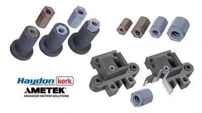

The leadscrew-nut inserts have a threaded interior (with a high-efficiency thread form) and a hex-shaped exterior to embed into flanged nut bodies or into more-complex 3D-printed prototype assemblies. In addition to the hex shape, which radially locks the insert into the nut body or assembly, each insert also includes a ring groove that (with adhesive) axially locks it into place.
The 3DP nuts support OEMs that use additive manufacturing for short lead times. These nuts are made of advanced materials that are engineered explicitly for production-part performance. That means the nuts transmit power in a way that’s more representative of how standard volume parts will operate under load, which in turn boosts design-verification accuracy.
Currently, Haydon Kerk offers the 3DP nut inserts in a lubricated polyacetal or a proprietary Kerkite KN30, a self-lubricating, high-performance engineered polymer.
