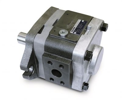

The variable-speed IPS internal gear pump improves control
The newly developed variable-speed IPS internal gear pump meets the tighter requirements on dynamic behavior and robustness in the area of servo drives. The new variable-speed pump, with its design innovations and the use of specially developed materials, makes machinery more productive and more efficient. The pump may be installed in existing servo drives but it is also available as a complete system with power-pack technology. In addition, the IPS internal gear pump is already compatible with Industry 4.0 because it is prepared for the required sensor technology.
