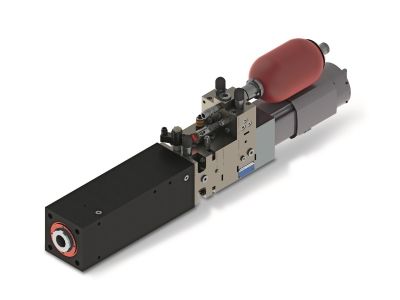

Reduce Energy Costs by up to 50 percent – the Self-Contained CLDP Servo Drive from Voith The Voith CLDP servo drive (Closed Loop Differential Pump) can be used for all direct linear motions, especially when dynamic response, reproducibility and reliability are needed. Enhanced productivity, high energy efficiency, full programmable position or force control and longer lifetime of the drive, are attractive features for plant operators. They are almost wear-free and have an unrestricted overload protection. Unlike electromechanical drives this self-contained servo drive offers customers the full range of benefits of a hydraulic systems solution.
