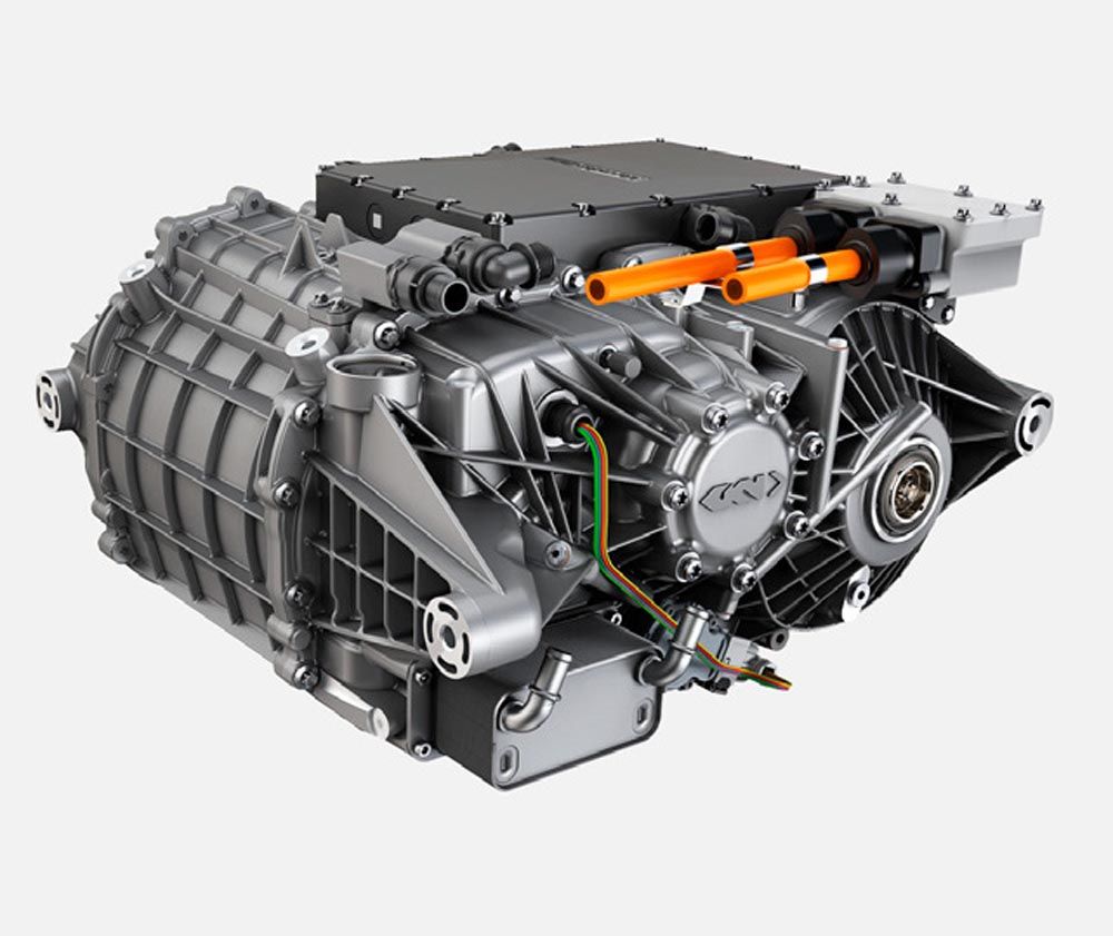

GKN’s modular and scalable electric drive (eDrive) system can fulfil customer requirements for a wide range of vehicles.

By creating a modular and scalable electric drive (eDrive) system—consisting of the inverter, motor, and reducers (single- or dual-speed)—we can fulfil customer requirements for a wide range of vehicles. We can, for example, use three standardized motors to offer a power range of between 60 and 300 kW, depending on the customer’s requirements.
