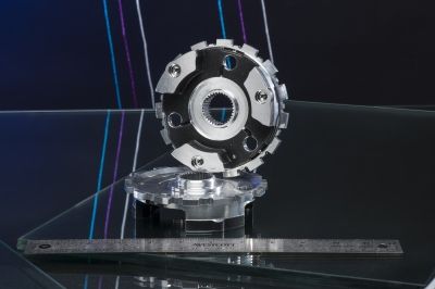

The Grand Prize in the Automotive—Transmission Category was awarded to GKN Powder Metallurgy for an aluminum planetary reaction carrier made for General Motors. The carrier goes into the all-new GM 9T50 9-speed transmission offered in such vehicles as the Chevrolet Malibu and the Equinox crossover. Compacted of a unique metal-matrix-composite (MMC) aluminum alloy system and mated to an overdrive carrier, this first-of-its-kind two-piece design required industry-first tolerances.
