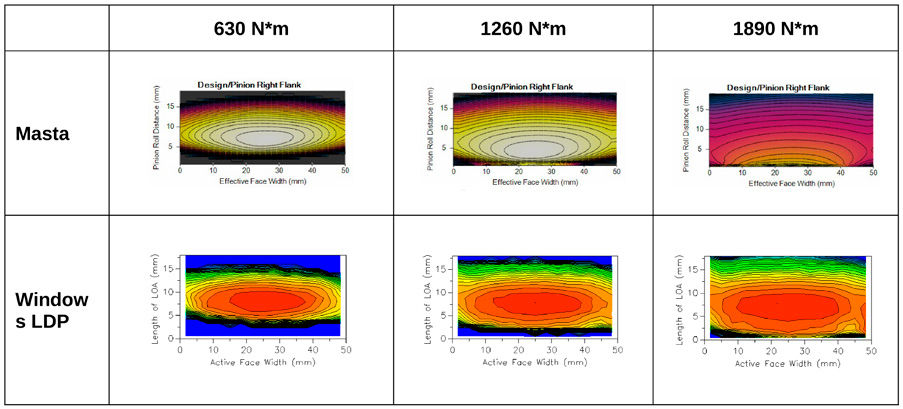

The contact stress results for the nominal load case are shown in Figure 1. There are noticeable differences in contact pattern position, with Masta’s contact pattern position lower than Windows LDP. The max contact stress in Masta is three percent lower than in Windows LDP.
Figure 1—Contact stress contour for nominal load: a) Masta, b) Windows LDP.

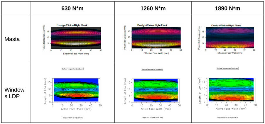

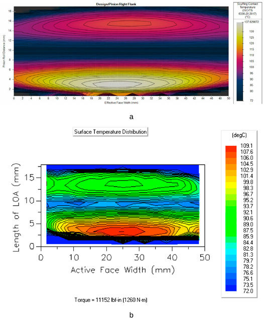

Scuffing surface temperature results are used in both software for scuffing rating. Masta uses flash temperature. Windows LDP uses temperature calculated analytically based on physics. Both temperatures cannot be verified by physical measurement. Figure 2 shows the nominal case results.
Figure 2—Surface temperature contour for nominal load: a) Masta, b) Windows LDP.
The pitch has the lowest temperature due to zero sliding velocity. Each software predicts the highest scuffing surface temperature below the pitch line toward the pinion root. Masta’s max scuffing surface temperature is 20 percent higher than Windows LDP.
The contact stress and scuffing surface temperature contours under different load conditions are summarized in Table 3 and Table 4.
Table 3—Contact pattern at various torques.
Table 4—Surface temperature at various torques.
When torque increases, the contact pattern on the pinion spreads larger and shifts toward the pinion root. Both software predict a similar trend. However, Masta predicts edge contact at high torque, which is not reflected in Windows LDP. The tooth bending model in Masta is based on the Lewes bending assumption used in ISO standards, while Windows LDP uses an FE-based solver. Detailed discussion can be found in Refs. 8,9. The scuffing surface temperature results are largely based on the contact stress distribution. Masta scuffing surface temperature result is 40 percent higher than Windows LDP at high torque, compared with 11 percent at low torque.

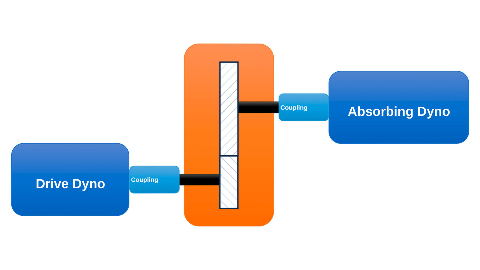

Figure 4 shows the layout for the testing dyno, which uses two dynos for driving and loading. Compared to the four-square layout (Refs. 12,13), each test takes less time to set up, and the torque and RPM of the testing are not affected by the test rig’s secondary gear pair.
Figure 4—Test rig layout.

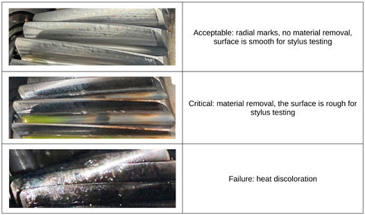

The selected gears are tested by loading them stepwise in five stages, operating for 15 minutes at each load stage while maintaining the assigned pitch line velocity and an initial lubrication temperature of 85°C. The lubrication nozzle type, diameter, jet type and nozzle position can be altered, allowing control over lubrication flow rate and lubrication starvation, which is not directly reflected in the analytical software. The analytical software assumes sufficient lubrication, but the data can be fed into the software calibration database for that specific lubrication condition.
After each load stage, the gear flanks are visually inspected for scuffing marks. The failure load stage is identified when the gears reach a critical condition or failure, as listed in Table 5. Exit lubrication temperature and test rig vibration can be monitored to help identify the occurrence of scuffing failure.
Table 5—Scuffing visual assessment guide.

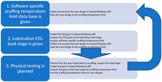

Software Correlation and Scuffing Rating
To use either Masta or Windows LDP for scuffing rating, the process shown in Figure 5 is proposed. In most applications, the lubrication FZG stage is provided at the initial design stage. Method 2 can be used to obtain initial results for the scuffing rating. Scuffing is a phenomenon resulting from gear-lubrication interaction. The new gear design will exhibit different scuffing performance compared to standard FZG gears. Method 3 can be employed as a validation or correction for the analytical solution. Subsequently, the data can be fed into a scuffing surface temperature limit database. A key takeaway from this research is that the database is software-specific and cannot be transferred between different software due to the use of different solvers based on varying theories.
Figure 5—Software correlation and scuffing rating process.
