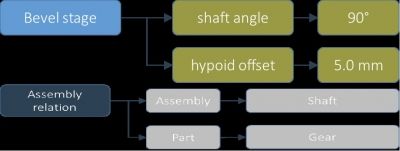

n REXS, the components of a gearbox are defined based on common parameters. The REXS specification includes everything necessary to define a gearbox model. Essentially, this includes the machine elements, their attributes, and the relations which are used to define the relationships between machine elements. The simple and generic structure of REXS makes it possible to depict individual components, assemblies, and complex gearbox structures.
The interface has an open architecture, so companies can define their own extensions without affecting the standard. Thus, the interface is suitable for exchanging data between standard programs as well for internal use with custom software solutions.

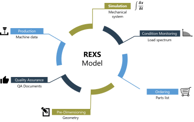

Although the current version of the interface is focused on the definition of gearboxes for calculation programs, the possibilities for future development are broad. According to the motto "If you want to achieve great things, you have to set high goals," FVA's vision for REXS is to develop an interface that can be used for all CAE powertrain applications.
“REXS is a real step toward new business models based on digital services, and can be used as a standardized data container for digital twins,” said Evert.
The FVA Workbench is a platform in which new concepts for the further development of REXS are already being implemented and tested for practical suitability.
