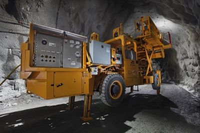

Freudenberg Battery Power Systems’ XMP76P battery sub-pack, part of its XPAND Modular Pack portfolio, is providing safer, more cost-efficient, zero-emission muscle to power MacLean’s EV-Series™ battery-electric mining equipment. MacLean chose the XMP76P to provide safe, more cost-efficient, zero-emission muscle to its EV-Series rock breakers, boom trucks, explosive loaders, bolters, cassette carriers, road graders, concrete trucks and sprayers and other mining equipment. The XMP76P also offers design flexibility and MacLean has configured more than 30 kinds of vehicles to accommodate the Freudenberg battery system.

The XMP76P, part of Freudenberg’s XPAND Modular Pack portfolio, is powered by XALT Energy’s premium lithium-ion cell technology. MacLean will use several sub-packs in series to provide energy levels of more than 106 kWh per vehicle. Building on a successful, five-year history of offering battery-electric equipment to mining companies across Canada, MacLean is now focused – with premium batteries from Freudenberg – on expanding its diesel-free, fleet options to customers around the world.
