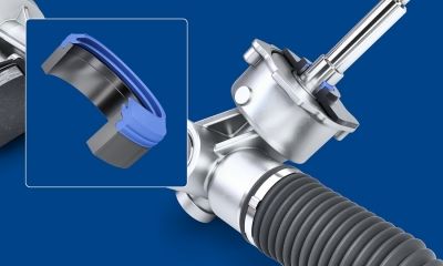

Freudenberg Sealing Technologies has introduced a machine component that combines a plastic rotating bearing with a seal in a single, precisely matched unit. The design offers significant weight, cost and friction advantages over separate bearings and seals and improves the properties of the mated bearings and seals. Freudenberg has validated the advantages of this new component through extensive testing performed in a sensor housing unit including the seal-bearing component.

Freudenberg has resolved this challenge with the introduction of its seal with integrated bearing (SWIB). The company spent two years developing this engineered solution and has successfully tested it in a sensor housing of an electric power steering (EPS) system installed in an electric powered vehicle.
The sensor records data, like steering angle, which is critical to advanced driver assistance programs like electronic stability control (ESC). The seal inside the housing is responsible for protecting the sensor from the penetration of dust, splash water and other media over the entire service life of the vehicle. Bearings used in the assembly are also important; they must withstand significant mechanical loads – sometimes as much as 3,000 Newton of radial force when a car drives over a curb with its wheels at an extreme angle.

Freudenberg Sealing Technologies’ integrated solution offers significant improvements compared with separate bearings and seals. The rigidity of the integrated plastic bearing is higher so that its deflection is reduced by nearly 50 percent when lateral forces are exerted. This reduces the induced vibrations to increase the steering comfort for the driver. The seal, on the other hand, has 35 percent less friction, which reduces resistance during steering – especially important for highly automated driving. The weight of the overall solution is reduced by as much as 80 percent through integration. Freudenberg’s patented plastic bearing plays a major role in achieving these component breakthroughs.
Automotive safety applications are subject to many requirements which individual manufacturers define according to their own specifications. Freudenberg Sealing Technologies used common specifications – a temperature resistance of -40 to +125 degrees Celsius under mechanical stress, for example – to test its integrated component during the past year. Extreme cases, such as direct exposure to high water pressure, which can occur in practice during engine washing, were also tested. The seal that includes an integrated bearing proved itself in all tests. “We can now commence with customer-specific series development at any time,” says Freudenberg expert Frank Schönberg.
