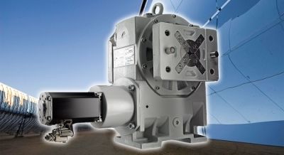

Within one year (from August 2012 to August 2013), almost 5,000 drives have been supplied to India and to two projects in the USA. A single drive controls six reflectors with a total mirror surface of 330 square meters. With a weight of approximately 75 kg and outside dimensions of about 480 x 410 x 240 mm (H x W x D), the drive is both compact and robust.
Motion is ensured by a 400W brushless DC motor provided with a CAN-Bus interface for central control. This motor is connected to a planetary gear developed especially for this control, which supplies an integer gear ratio in all three stages. The following worm gear set has been designed with an extremely low backlash in order to ensure the required positioning accuracy at the output shaft. The integrated absolute encoder with SSI interface measures the accuracy of the drive thanks to a specially developed arrangement of backlash-free gearwheels on the encoder shaft and on the output shaft, therefore offering the possibility of an individual re-adjustment by the control.
The interaction between positioning accuracy on the one hand and torque on the other hand was one of the challenges of this project. The required torque entailed a relatively high reduction ratio, for this reason, the necessary accuracy could only be achieved using highly accurate toothed components with extremely low backlash.
