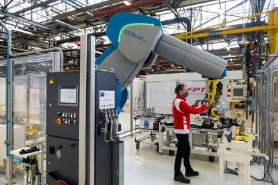

Here, in the department dedicated to assembling spindles for heavy equipment axles, AURA (Advanced Use Robotic Arm) operates: this is a robot designed and built by Comau and used in the HuManS (Human-centered Manufacturing System) project, launched in the area of the Piedmont Region tender dedicated to the Intelligent Factory Platform and with which FPT Industrial, Comau and another 17 companies specialized in the sector participated. It is a project that places humans at the center of the production system, surrounded by machinery that helps and shares the space with them in complete safety.
Almost three meters high and weighing about three tons, AURA is a collaborative industrial robot capable of working alongside humans, without barriers and in the same work station, to help them and perform the most tiring and repetitive tasks and, where necessary, it is ready to be manually guided by the human operator. Specifically, AURA retrieves a part from the supply cart in complete autonomy and delicately hands it to the operator it shares the station with. And it is precisely the human operator who, at this point, takes control of the operations, guiding the robot using a specific handle so that the mechanical arm takes the part to the work bench, where it is coupled with a lever.
Perfect collaboration and synergy, where each of the subjects involved is able to perform at their best. The robot performs the heavy work methodically and effortlessly, the only collaborative machine on the market capable of lifting up to 170 kilograms, whereas the delicate assembly stage is controlled by a human, thereby using human skills to adapt to operational situations and assembly strategies that vary from model to model, sometimes greatly.
But strength is not the only feature that makes AURA a robot without rivals. In fact, in its role as a collaborative machine, it must be able to perceive a presence, whether it be other machinery or a real person, in the space where it operates and consequently modulate its behavior. And, in order to do this in the best possible way, it uses its “senses”.
A “sensitive skin” - soft and inspired by human skin - that allows it to decide whether to reduce its speed or stop entirely. A “view” in the form of a 3D camera that the robot uses to scan the piece being retrieved in order to perceive its position. And last, but not least, “the touch” it expresses through a gripper, capable of lifting the component being moved with a firm, but delicate grip. But that's not all. In order to work without any barriers alongside a human on the FPT Industrial driveline assembly line, AURA was outfitted with a true “sixth sense”: an advanced and complex laser scanning system that investigates and monitors the work space when the arm is in operation.
