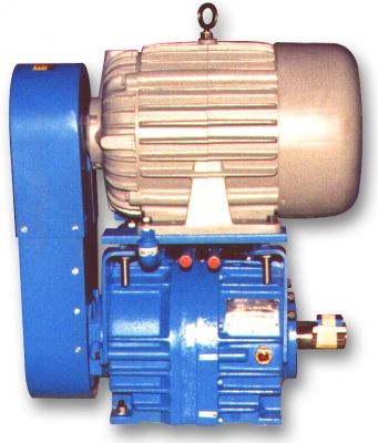

Posidyne clutch brakes, with oil shear technology that allows rapid and precise stopping, starting, reversing, speed change and positioning, all without adjustment or maintenance, are now available in space-savings piggyback designs. Special pads cast into the main housings mount an adjustable motor base, allowing the motor to sit atop the clutch
brake.  Other components include a gear belt drive from the motor to the input shaft and an enclosed belt drive guard.
