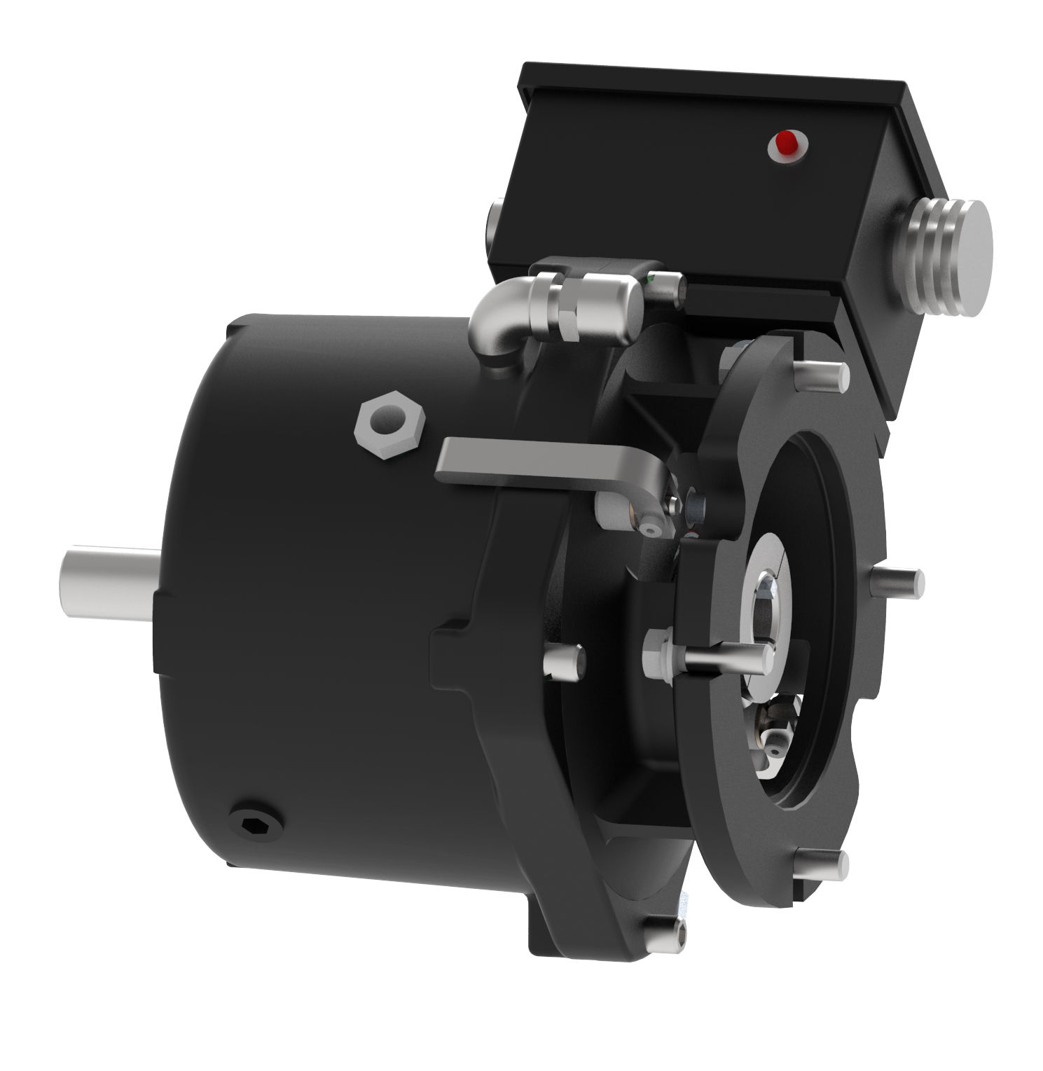

Force Control introduces the Magnashear electric coupler brake which features oil shear technology to provide precise stopping and repeatable positioning, in a compact footprint. They are ideal for demanding applications where the motor is reversed each cycle or there are frequent start/stop cycles. Unique oil shear technology and multiple friction discs allow for high heat dissipation and low inertia, providing a lot of stopping power in a compact package. Aside from an annual oil change, there is no maintenance or adjustment required. They are ideal for cranes, hoists, conveyors, winches, rail car spotters and dumpers, ship and rail car loading conveyors, trippers, pallet returns, elevators and more.
Proven oil shear technology transmits torque between lubricated surfaces – thereby eliminating wear on friction surfaces.  A patented fluid recirculation system dissipates heat – eliminating heat build-up which is the most common problem in dry braking systems.   Elimination of the wear significantly increases service life and virtually eliminates adjustment which also elongates maintenance intervals. The oil shear technology also provides a smooth “cushioned” stop which reduces shock to the drive system, further extending service life of downstream components.
MagnaShear brakes are spring set, electrically released – 115 or 230 VAC through pulse width modulation for reduced heat and significant energy savings. An innovative Split Clamped Quill feature reduces shaft and key/keyway damage to the motor shaft associated with competitive brakes. The split quill collar tightens the quill 360 degrees around the shaft and key for superior connection.
Totally enclosed Magnashear brakes are impervious to moisture, dirt and dust that is common in many production environments.
