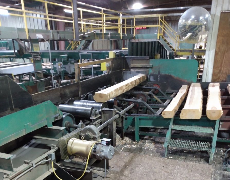

A conveyor chain feeds logs into a sawing station which cuts each side of the log. The log then continues down a conveyor until reaching a backstop, tripping a sensor that engages the motor and releases the brake on a second conveyor which is perpendicular to the first. This second chain conveyor incorporates lugs. Once engaged, logs travel approximately 4 feet or so to another conveyor which carries the lumber onto further processing.  After depositing the log, the lugs trip another sensor which engages the brake and stops the motor, which in turn stops the chain until the next log strikes the backstop, at which point the process repeats itself.
The drive motor was originally fitted with a dry-friction brake. However, continual activation of the brake (1,400 and 2,400 cycles per day) was creating a maintenance nightmare. On average, brake discs were being replaced every three weeks or so. Furthermore, the brakes’ heat of engagement was burning up transformers leading to more failures and unplanned downtime.
“We were burning up the transformer because the brake pads would get so hot that the transformer would melt,” said Electrical/Automation Technician Damian Fleischmann.  “The repetition and the friction were causing so much heat that it was just burning everything up inside.”
Replacing the brake discs was challenging because the discs first needed to cool-off as to not burn the technicians replacing them.

When considering their options, the mill production manager recalled a Force Control Oil Shear Brake in another location of the mill that was operating smoothly without downtime for maintenance or adjustment.  After conferring with local manufacturer’s representative, Dave Dilworth, they purchased a MSB6 size Magnashear which was quite easy to install.
“We have a mechanical starter on ours,” said Fleischmann. “I wired up the brake through an auxiliary contact with the control voltage, so that once the motor is engaged, the brake is disengaged. It is instantaneous on both.”

With the old braking system, engaging the brake would generate heat, causing the friction material to glaze-over. Consequently, this would cause variance on the stopping distance which lead to necessary air gap adjustments. Brake pads would also wear out and require replacement.  All of this maintenance and adjustment meant the stacker was out of commission and the mill would remain shut down until the brake could be repaired or replaced.
The MSB6 currently installed on the lift has been in service since June of 2018 and requires virtually no maintenance.  “Other than changing the fluid every six months, you don’t have to do anything to them,” said Fleischmann.
