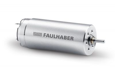

To control the individual fingers, Bioservo uses DC-micromotors with graphite commutation of the 1741 … CXR series in their Ironhand. The series combines power, robustness and control in a compact form. This is ensured by graphite commutation, high quality neodymium magnets and the tried-and-tested winding of the Faulhaber rotor. The powerful neodymium magnet gives the motors a high power density with a continuous torque ranging from 3.6 to 40 mNm. The impressive performance data and the compact size open up a wide spectrum of possible applications at an optimized price/performance ratio.
