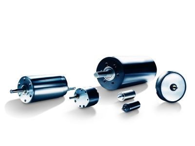

At the heart of the DC miniature and micromotors from Faulhaber is the patented, self-supporting, coreless rotor coil with skew-wound design and brush commutation, which rotates around a fixed magnet. This motor is also often referred to as a bell-type armature motor due to its look. Its design not only has many practical benefits, it also influences the selection of the motion controller.
No cogging torque forms due to the symmetrical air gap, which enables precise positioning and excellent speed control. The ratio of load to speed, current to torque, and voltage to speed is linear. And as almost the entire motor diameter can be used for the winding, the motors achieve higher power and torques for their size and weight compared with conventional designs. The rotor’s low inertia also guarantees an extremely low electrical time constant. The motors can thus be operated very dynamically and heavily overloaded.
Triple continuous torque in overload mode is quite common and easily possible for servo applications, as long as the temperature of the motor winding is monitored. But motors with a diameter of only 22 mm or less don’t have an integrated temperature sensor. There simply isn’t enough space. So if just any controller is connected to a microdrive, in the worst case the coil may be completely burnt up before any heat is even noticed on the outside.
