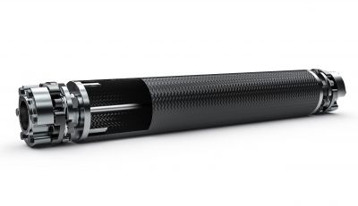

One featured coupling innovation is R+W’s redesigned disc pack coupling line.  A special model is now offered with an integral coolant tube which can transport cutting fluid directly to the workpiece over long distances.  The coupling also features vertical support, and special adaptation interfaces on each end.  This offers valuable benefits to manufacturers of machine tools with long spindle drives.  These couplings are often used in highly dynamic and high speed applications.  For that reason, lightweight carbon fiber (CFRP) or aluminum spacer tubes along with symmetric conical clamping hubs are used.  The torsionally rigid disc packs compensate for misalignment between the connected shafts.
