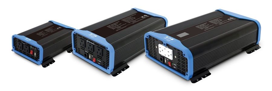

Eaton Tripp Lite Series Pure Sine Wave Mobile Inverters
Purpose-built for fleet vehicles, service trucks, RVs and remote job sites, the Tripp Lite Series offers a lower-cost, simplified solution for light vehicle applications. These inverters deliver pure sine wave output to support laptops, tablets, test instruments and other sensitive electronics—helping them perform at optimal speed, temperature and reliability. Select models offer LCD monitoring, USB charging and remote operation.
Key benefits include:
•    Pure sine wave AC output for sensitive electronics
•    Up to 3000W continuous / 6000W peak power
•    One USB-C (18W) and one USB-A (10.5W) charging port
•    Compact, lightweight installation with included wiring and brackets
•    Optional LCD display and remote control
•    LEDs and audible alarms for voltage, temperature and overload
•    Temperature/load-controlled cooling fan
•    UL 458-certified with GFCI outlets on 2000W and 3000W models
