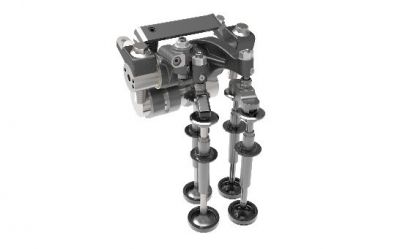

Eaton’s VVA solutions are based on two building blocks: 1) a rocker with a switchable capsule, and 2) a split rocker for full deactivation. By combining these two building blocks, several VVA strategies can be utilized in virtually any engine architecture – single and dual overhead cam, as well as cam-in-block engines – and engine displacement ranging from 2.0 liters to 15.0 liters.
