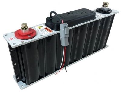

Supercapacitors, lead-acid batteries for 48-volt system power storage
Eaton’s Vehicle Group is developing a wide range of 48-volt energy storage solutions, including lead-acid batteries and supercapacitors.
“We’re integrating various energy storage technologies into a larger storage pack including controls, fusing, and contactors,” said Karrer. “Eaton’s Electrical Components Group is our partner for supercapacitors, and we will be working with most commercial vehicle battery manufacturers for lead-acid batteries.”
Lead-acid batteries are inexpensive compared to lithium-ion packs and offer a safe and more efficient solution, with a longer lifespan when compared to existing lead-acid battery applications.
Supercapacitors are able to quickly charge and discharge at higher rates than lithium-ion batteries. While the size and weight are comparable to lithium-ion packs, supercapacitors don’t retain high levels of energy in comparison or require a liquid cooling system, and they have a longer cycle life.
