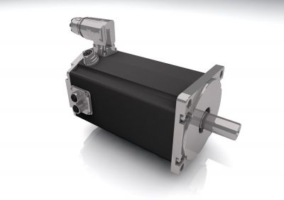

Dunkermotoren Integrates PROFINET into Servomotor
Since the end of February 2021, Dunkermotoren's fully integrated PROFINET solution has been officially certified by the PROFIBUS user organization.
This means another important feature is fully integrated into the motor, which is a milestone in terms of cabling, commissioning and IIoT capability. Dunkermotoren is the first drive technology manufacturer to fully integrate its certified PROFINET solution with PROFIdrive into a motor.
The certification assures Dunkermotoren that the high standards of stability, even under extreme bus conditions, are always maintained. Currently the products BG 95 dPro, BG 75 dPro, BG 66 dPro and the BGE 5510 dPro are available with PROFINET interface, covering the output power from 1 to 4,000 W.
