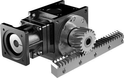

Drive Lines Technologies, the specialist provider of power transmission solutions, now offers a complete linear drive solution incorporating rack and pinion mechanisms that complement the MS-Graessner ranges of precision servo gearboxes, including KS-TwinGear, DynaGear, DynaGear DG and DynaGear PL systems.
These comprehensive solutions include low-backlash precision gearboxes, shrink-fit direct shaft mounted pinion gears and precision toothed racks with dedicated lubrication systems. They offer independent, precise sub-systems that can be easily mated to a wide range of Servo motors and installed and maintained on many automation systems.
The racks’ drives are available in a number of precision classes and can be supplied to suit individual applications. The teeth can be cut straight or helical; have milled or ground flanks; and are hardened for durability. A range of pitch error tolerances combined with the Graessner gearboxes backlash options enables them to offer Professional, Ultimate and Ultimate Plus precision grades.
The DynaGear System range is designed to be smart, light and accurate. It is available in eight sizes from 53 Nm to 2,160 Nm and can generate feed forces up to 35 kN. Gear ratios range from 3:1 to 100:1 and with input motor speeds up to 8,000 rpm, output speeds up to 10 m/s can be achieved. To meet the needs of a wide range of applications, it is available in three precision classes and gear module sizes 2 to 6.
DynaGear DG Ecosystem, is a highly efficient and economical solution. Available in a smaller range of sizes 53 Nm to 390 Nm, maximum feed force is 11 kN and top speed is 6 m/s. Gear ratios from 5:1 to 15:1 are available and there is a choice of 2 precision levels, module sizes 2 to 4.
DynaGear PL Ecosystem is a compact, efficient and economical solution. Its smaller sizes range from 53 Nm to 210 Nm; feed force is up to 8 kN and output speed can reach 6 m/s. Similar to the DG, gear ratios are from 5:1 to 15:1 with two precision classes and Module size 2 to 4.
KS TwinGear System units are designed to be compact, highly powerful and accurate. They are available in eight sizes from 225 Nm to 1,1250 Nm and can produce feed forces up to 200 kN. 8,000 rpm motor input speeds allow output speeds of up to 4 m/s and transmission ratios up to 75:1. Larger gear modules are available to suit from 2 to 8.
All rack and pinion systems supplied by Drive Lines can be fitted with an integral, automatic lubrication system that can be tailored to individual requirements.
Linear guidance, couplings and other components can also be selected to complement the Gear System solution to offer a package of parts for any precision and dynamic automated linear axis.
