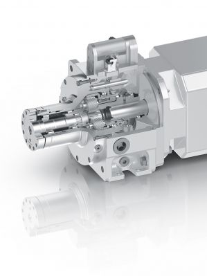

While there are numerous different gearbox designs, planetary gears offer a number of advantages in machine tool applications. For instance they are more compact than most alternatives because the power transmission is shared between several gears, and space saving is always useful in machine design. They are also quiet, reliable and easy to use.
Drive Lines offers the ZF Duoplan gearbox, which is ideal for use in machine tools and many other applications. One of its design features, the floating sun gear, means the Duoplan is tolerant of misalignment and concentricity issues that may arise in machine tool applications. This reduces the generation of heat and vibration during operation, improving reliability and extending the working life of the unit. Further, combining the simultaneously meshing planetary gears with a helical gearing profile assures low noise, even at high operating speeds.
Characterized by their optimized torque transmission capabilities and superior low speed performance, the ZF Duoplan can be used in horizontal or vertical configuration. They can connect straight to the spindle motor without the need for additional components, thus further promoting operational reliability.
