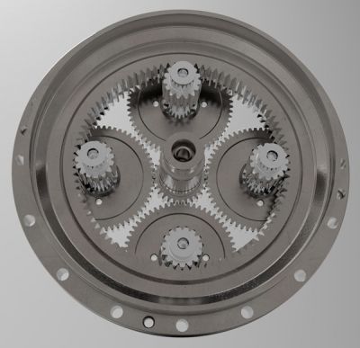

Planetary gears are also called epicyclic gears or sun-and-planet gears, the latter being useful for helping visualize their operating principle. Dismantle a planetary gear and at first it looks complicated, but you can soon identify a central sun gear, surrounded by, and meshing with, some planet gears. Holding the sun and planet gears together are an outer ring gear with internal teeth that mesh with the planets. There is also a planet gear carrier, but this does not transmit power, it simply keeps the gears in place.
If the sun gear is turned, the meshing teeth cause the planet gears to turn, which then cause the ring gear to turn. It sounds complicated and looks hypnotic, but in fact is very simple. It is also notable that the ring gear turns in the same direction as the sun gear.
Significantly, while the sun gear rotates relatively quickly, the outer ring gear rotates more slowly. In fact the ratio of their two speeds is derived from the ratio of their two diameters – the planet gears act as idlers, their role being to transmit power between the sun and ring, in other words their diameter does not affect the overall speed ratio between input and output.
This configuration offers some very significant advantages over other gear layouts. For instance, all the parts fit inside the ring gear making it a compact unit. Because there are a number of planet gears, there are many teeth meshing with one another, each pair transmitting power and adding together to give a high torque capability in a compact unit. The multiple meshing of teeth also helps to significantly reduce backlash compared to a gear system where there is only one meshing pair. Also, because the power transmission is spread equally across each planet gear, there is an innate symmetry which helps prevent the gearhead from flexing under load.
