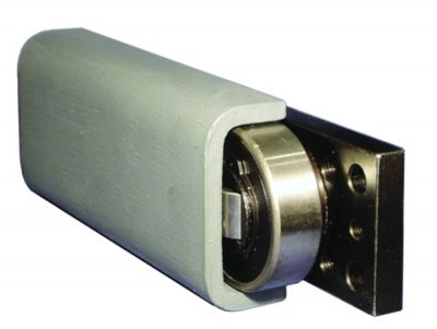

Combined bearings provide a cost-effective guide solution to lifting systems, platforms and cantilever loads. The system combines a radial bearing to take out high moment loads and a smaller axial roller to eliminate side movement. They are often used to guide screw jack lifting and sliding systems by isolating the screw jack drive from all side forces and moments, allowing for smaller and more cost-effective sizing of the screw jacks; especially under compressive buckling situations.
These combination bearings are often welded to a mounting flange plate for ease of fitment and replacement on the application. The flange plates offer a standard size with tapped and thru holes but square plates and special plates are available for ease of mounting. The flange plates are offered in standard rectangular sizes with tapped and thru holes but square plates and special plates are available for ease of mounting to customer fabrications.
The sealed and greased bearings offer robust guidance for fabrication mounting and with no external grease or oil required they are ideal for clean industrial environments. The bearings are designed to run in a hot rolled steel section in U and I configurations. These soft steel profiles are easy to machine, weld and integrate into fabrications and are sometimes used as structural members also due to the high rigidity of the sections.
