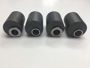

Drake Motorsports Development, LLC was recently formed to accelerate the availability of track proven race parts and to continually develop new racing products from a racing industry insider perspective. The first part developed is an offset control arm bushing machined from Torlon 4435. The bushing delivers an increased static negative camber range of adjustment for the front wheels, which is used as a suspension tuning method to optimize tire contact under high lateral loads. Tyler Quance, owner of Drake Motorsports Development, and the engineering manager for Drake Plastics, has been racing a Spec Miata with a set of these bushings since mid-2017. During this time, the bushings have shown no measured wear. The bushing material is self-lubricated and requires no grease, making a totally maintenance-free, non-consumable part which is intended to last as long as the racecar.
The bushing was designed in collaboration with Chris Haldeman and X-Factor Racing of Princeton, Texas. This collaboration resulted in a decision to supply the bushings already installed in control arms with a steel anti-rotation dowel pin to ensure each bushing stays in place under demanding race conditions, and to finish ream the offset hole after installation for a precision fit with the steel inner sleeve. This process saves the customer a great deal of time and hassle during installation and ensures the bushing set is aligned to deliver maximum available front wheel camber in a ready-to-bolt-on assembly.
The extreme wear resistance and excellent lubricity of Torlon 4435 provides the combination of improved performance and improved part life. This grade and suspension bushing application supplied previously by Drake Plastics, has a pedigree with the Risi Competizione Ferrari race team.  Now that Drake Motorsports Development is assembled to expand the accessibility of Torlon 4435 bushings as performance aftermarket parts, Torlon is poised to obsolete traditional bushing materials in higher-end performance and racing applications. According to Quance, “once drivers and race prep shops try Drake Motorsports Development’s Torlon 4435 suspension bushings, I expect they will want to use them exclusively.”
