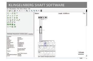

Generating the measuring program with the Klingelnberg “Shaft Software” is an easy task. For roller bearings an automatic measuring cycle generation based on a parametric description of roller bearings is available. Thus the measuring program for one bearing type only needs to be generated once. By reading in the parameters from a data source the measuring cycle for different sizes of this bearing type are automatically generated without any user interaction. An example of different bearing sizes with the parametric measurement program generation is shown in Figure 3.
Figure 3: Parametric measuring program generation.

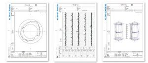

An example with results for different kinds of measuring tasks are shown in Figure 4. Standard tables with the actual values, the nominal dimensions and tolerances for GD&T measurements as well as graphs giving an idea of the form error shape are listed here. This way the machine operator receives all necessary information in order to analyze the manufacturing process and find measures for quality improvements. For surface roughness, there are options to choose the graphical view as well as the specific values according to the relevant standards. Special evaluations are also available including the Fast Fourier analysis FFT to analyze roundness errors as well as noise issues caused by a bearing. Since all these analyses are performed on the same machine with a fast rotary table and a scanning probe, measuring time can be reduced up to 46 % compared to a standard setup.
Figure 4: Typical measuring reports for bearing rings.
