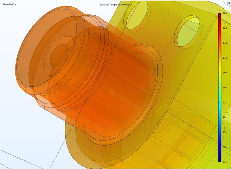

In Figure 2, we show the results of the internal operating temperatures of an automotive water pump. In this analysis we model all: the motor, the integral drive and the coolant flow. We analyzed the transient thermal behavior at 85°C ambient temperature. The picture in Figure 2 was taken after six minutes of operation.
Holling-Fig2.jpgFigure 2 Thermal analysis of an automotive brushless motor water pump.

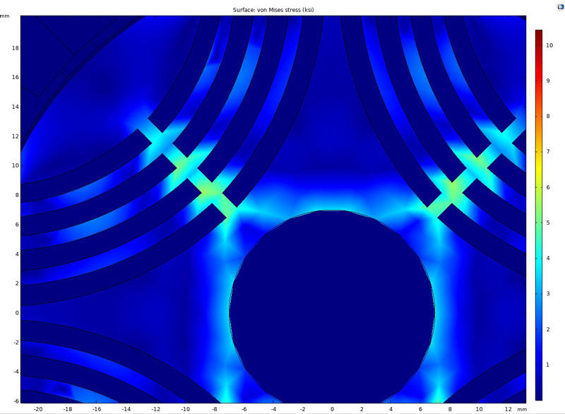

In Figure 3, we show the internal rotor stresses in a synchronous reluctance motor at 15,000 rpm.
Holling-Fig3.jpgFigure 3 Rotor stresses at 15,000 rpm.

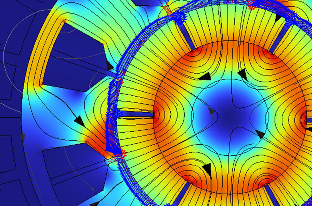

In Figure 4, we show the surface stresses due to the magnetic fields in a brushless PM motor.
Holling-Fig4.jpgFigure 4 Surface stresses in brushless motor due to magnetic forces.

All of the above examples are based on the simultaneous analysis of a common model for magnetic performance (torque, efficiency); thermal analysis, which feeds back into the copper losses; mechanical analysis (strength), which takes into consideration the forces between the stator and the rotor and also the acoustic noise and many other important data points of the system performance, e.g., critical frequencies, bending moments, etc.
After the initial learning curve, it requires little extra effort to simultaneously solve for a multitude of physical characteristics of a given design far beyond the basics of torque and efficiency.  In a modern design environment, we must take a more holistic view of the design task and analyze a multitude of physics simultaneously to quickly generate accurate and optimized designs for our applications.
