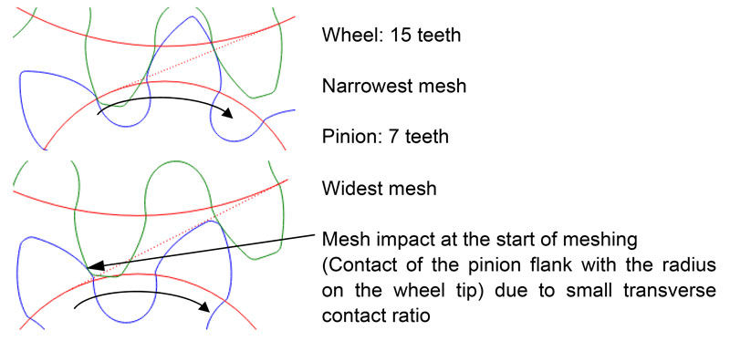

Figure 1 shows gear meshing according to a conventional design similar to DIN 58400 (Ref. 2) , with tolerances typical of a microgear. According to conventional evaluation, the transverse contact ratio must be at least 1 over the tolerance range. For the widest mesh (Fig. 1, right) there is a transverse contact ratio of less than 0.6, with a correspondingly hard impact at the start of meshing. The results are noisy running and severe wear. Consequently a gearwheel design is required that ensures operating reliability — even with large tolerances.
Figure 1 - Conventional design, similar to DIN 58400 (Ref. 2).
Figure 1 — Conventional design, similar to DIN 58400 (Ref. 2).

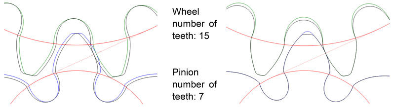

Step 1: specification of module and number of teeth. Multiple calculations have shown that for the design optimized here, the optimum number of teeth-per-pinion is 7. Figure 3 shows a design similar to Figure 1, but with 7 teeth on the pinion.
Figure 2 - Limited tooth depth with a small number of teeth; pointed tooth tip und undercut.
Figure 2 — Limited tooth depth with a small number of teeth; pointed tooth tip und undercut.
Figure 3 - Pinion number of teeth — 7; conventional design — basic rack: similar to DIN 58400 (Ref. 2).
Figure 3 — Pinion number of teeth — 7; conventional design — basic rack: similar to DIN 58400 (Ref. 2).
Figure 4 - Left — complementary toothing; right — pinion addendum and wheel dedendum increased.
Figure 4 — Left — complementary toothing; right — pinion addendum and wheel dedendum increased.
Figure 5 - Pinion addendum and wheel dedendum increased.
Figure 5 — Pinion addendum and wheel dedendum increased.
The transverse contact ratio for the widest mesh is only about 0.8. There is a mesh impact at the start of meshing. The tooth depth on the pinion cannot be further increased due to the tip limit.

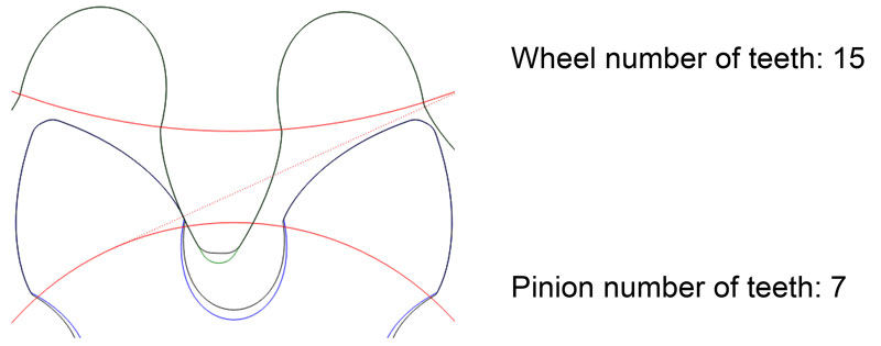

Step 2: increasing tooth depth by complementary toothing. Complementary toothing represents the state of the art: the tooth thickness of the pinion is increased while maintaining an unchanged tooth flank geometry and by counter-rotating the right and left tooth flanks about the gearwheel center. The intermeshing gearwheel is changed inversely (‘complementary’). These measures mean the teeth of the pinion are no longer pointed; therefore the tooth depth can be increased.
Step 3: increasing the tooth depth by accepting larger undercut. The tooth dedendum of the pinion and the tooth addendum of the wheel are increased; increasing of the already present undercut is accepted. Step 4: meshing optimization. At first sight the resultant meshing appears unusual, but definitely practical. Seen graphically, the contact ratio over the tolerance range is not optimal — but acceptable (Fig. 6). By calculation for the widest tolerance situation, a transverse contact ratio of approximately 0.9 results, which, while again not optimal, is a significant improvement compared with the conventional design (Table 1).

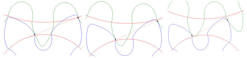

Increased tooth depth according to Figure 6 Pinion 7 teeth, wheel 15 teeth special approx. 0.9
The mesh as shown in Figure 6 still exhibits weak points; if tooth flank wear and pitch errors are considered, then, particularly with narrow meshing, the result may be a hard mesh impact or premature contact.
Figure 6 - Increased tooth depth according to Figure 5 for narrowest, medium and widest mesh.
Figure 6 — Increased tooth depth according to Figure 5 for narrowest, medium and widest mesh.

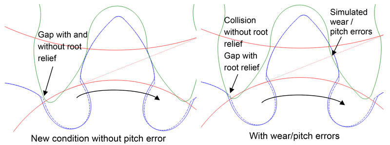

To prevent this collision the pinion is given root relief that, in comparison with more usual root relief, primarily recesses the dedendum in the area of the root surface or the undercut, and mandatorily only removes a small element from the involute form.
Figure 7 clarifies how this measure prevents a collision before the desired meshing. However, a small part of the involute form is lost, which further reduces the calculated transverse contact ratio for the widest mesh. It is for this reason that it is explained in the following which design and mesh are to be favored.
Figure 7 - Pinion without root relief (dotted line) and with root relief (solid line) with narrowest tolerance situation.
Figure 7 — Pinion without root relief (dotted line) and with root relief (solid line) with narrowest tolerance situation.

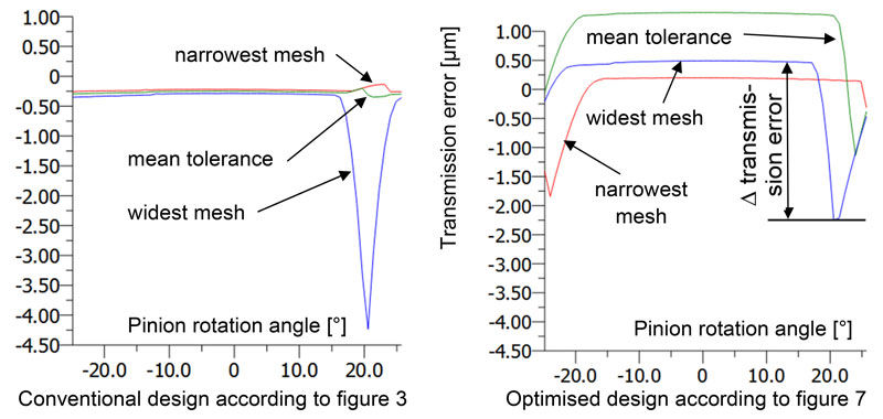

Figure 9 shows the calculated geometric transmission error for the conventional and optimized design — without elastic deformation and without pitch errors. The wide plateaus represent areas in which the involutes are in contact. The downward peaks are those areas between the involute engagements. Therefore the width of the peaks is a measure of how much the transverse contact ratio is less than 1. Indeed, the transmission error (more accurately, the difference between maximum and minimum values subsequently referred to as Δ transmission error) for the narrowest and medium mesh for the conventional design is approximately zero; by contrast, the widest tolerance situation is equal to a difference of about 4 µm. For the optimized design there are similar curves for the transmission error for the three tolerance situations. The difference between maximum and minimum value is between 2.0 and 2.7 µm, dependent on the tolerance situation. Moreover, the downward peak for the conventional design for the widest mesh is narrower than for the optimized design.
Figure 9 - Geometrically caused transmission error (calculated).
Figure 9 — Geometrically caused transmission error (calculated).

Metaphorically speaking, the transmission error represents for the conventional design a ‘narrow, deep pothole,’ while for the optimized design it represents a ‘wide, flat depression.’
Although a transverse contact ratio greater than 1 over the entire tolerance range is desirable, it is, however, not possible with large tolerances relative to the component size. Also, solely maximizing the transverse contact ratio is not appropriate. Table 2 very clearly indicates for the widest mesh that a smaller transverse contact ratio can even have a smaller transmission error as a consequence.
Table 2
Comparison: computed transverse contact ratio and Δ transmission error
    Conventional (Figure 3) Optimized (Figure 7)
Narrowest mesh Transverse contact ratio 1.0 0.77
Δ transmission error [µm] 0 2.0
Mean tolerance Transverse contact ratio 0.95 0.74
Δ transmission error [µm] ˜ 0 2.3
Widest mesh Transverse contact ratio 0.80 0.71
Δ transmission error [µm] 4.0 2.7
One reason the value of the computed transverse contact ratio for such toothing systems is to be considered with caution is that, as a result of undercut or root relief, there is from a calculated viewpoint no contact in the area of the involute. The difference between the actual contact and the involute contact may, however, be in the sub-micrometer range, i.e. — negligible in practice.
For evaluation of corresponding optimized toothing systems, it is therefore suggested that less consideration be given to the transverse contact ratio and that most attention be paid to transmission error. Moreover, the mesh, especially the start of the mesh, should be visually considered, which in fact partially results in a somewhat subjective assessment.
