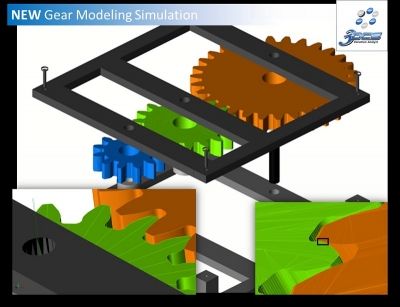

Dimensional Control Systems (DCS) is hosting a webinar to demonstrate how to simulate gear assemblies in 3D tolerance analysis software. This event will be presented by guest Tom Oetjens, CAE Integrations Inc., who brings his more than 40 years of experience developing proof of concept models for a variety of clients in CAE applications. The webinar, aptly named ‘New Gear Simulation Modeling’ will be hosted on Thursday, September 24th, 2020 at 11:00 am EST via Gotowebinar.
Gears need to work together, and identifying and fixing the root cause of misalignment before production begins is critical. Even the slightest misalignment can reduce performance, leading to lengthy delays spent identifying and fixing the issue and often involving high-cost corrective actions.
The focus of this event is to show both fine and coarse studies on a gear assembly, demonstrating the inputs and outputs and how they can be leveraged for reducing the risk of misalignments while minimizing variation through design iteration. This includes the analysis of tooth contact and complex gear mechanism dynamics with high accuracy, as well as how to fix issues with adjustments in bearings, shims, and pinion nut adjustment. This process provides the flexibility to make small adjustments in design that create a gear structure with minimal problems.
The use of 3DCS software can be used to assess gear backlash and mounting misalignment, perform angular backlash analysis, and create both flank test displays, and contact patterns. Using this solution integrated into the CAD platform allows for analysis of:
