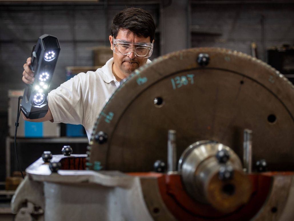

Enter DBS Transform from David Brown Santasalo - an innovative solution born from the synergy of cutting-edge structured light 3D scanners and nearly three centuries of combined gearing expertise. These 3D scanners significantly reduce the time required to reverse engineer a gearbox. In many instances, the necessary data to design a new complete drivetrain can be captured within a scheduled shutdown window of less 10 hours.
Once the 3D scanning is completed, the gearbox can resume operation while a new drivetrain is designed and manufactured at one of DBS's state-of-the-art gear manufacturing facilities. When the parts are ready, the transformation can be finalized at any of the numerous DBS service centers worldwide or even on the customer's site.
During this process, the gearcase undergoes a thorough inspection and refurbishment as needed. The end result is effectively a new gearbox with a recycled gearcase, ensuring peace of mind for the customer as the gearbox mounting interface remains identical to its original state.
