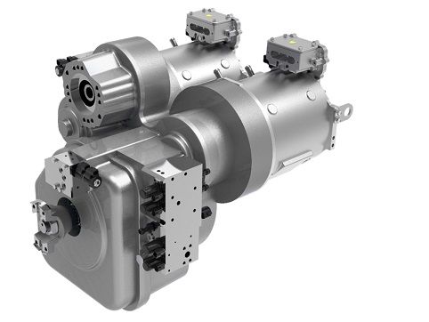

Leveraging Dana’s field-proven powershift technology, the eSP502 e-Transmission offers a dual-motor, two-speed design that is built on a flexible platform to enable optimized performance at maximum efficiency in a compact package. The modular approach to the transmission design allows for a single motor solution, as well as an optional power take-off, depending on the specific vehicle requirements. It recently made its North American debut at IFPE 2023.
Delivering high efficiency in a compact package that performs like a conventional powershift transmission, the dual-motor version supports continuous power outputs up to 326 horsepower (240 kW), while the single-motor configuration is engineered for 187 horsepower (140 kW) of continuous output.
The eSP502 is equipped with next-generation control software and functional safety readiness, enabling easy installation and smooth integration, and it features a patented clutch design that minimizes clutch drag to maximize efficiency.
It is equipped with field-proven Dana TM4 high-voltage motors of up to 800 volts to improve efficiency, reduce total package size, and provide redundancy as needed.
The eSP502 e-Transmission's compact and modular design allows it to be adapted for use in 4x2 or 4x4 vehicle applications with a range of ratio options to support a variety of vehicle types.
