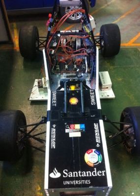

Having designed the drive system for its CRT01 electric car, the Cardiff Racing team approached LMC for the supply of two LEM-200 72 V, 15 kW DC motors and two PG Drives Technology Sigmadrive PMT835M controllers. The four-quadrant Sigmadrive controllers are supplying each LMC motor separately with a CANbus link to produce a differential effect and, like a hybrid vehicle, provide instant acceleration and regenerative braking to put energy back into the batteries. The electric drive system on the CRT01 is capable of providing a peak power output of 28.5 kW and rated torque of 400 Nm at 6,000 rpm.
