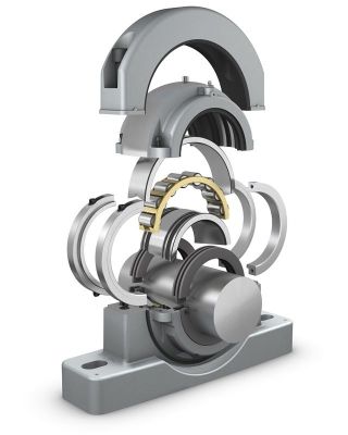

SKF Cooper split roller bearings can be fitted, removed and inspected without having to dismantle surrounding equipment, providing savings in terms of reduced maintenance and downtime. The products include both split cylindrical roller bearings and split double row tapered roller bearings, the latter with the ability to take axial loads in either direction. Both are housed and sealed in special swivel cartridges, which are suitable for mounting in pedestal or flanged outer housings.
The cartridges have a spherical outer surface that fits into a conforming surface in the mounting unit rather like a ball and socket joint; any shaft misalignment tends to move the cartridge, seal and bearing together, maintaining the seal on an axis parallel to the shaft. This configuration allows extremely close tolerances to be maintained between the housing and the shaft, delivering a sealing performance that is recognised as one of the best in the anti-friction bearing industry.
