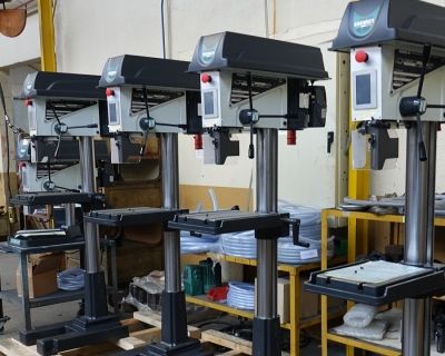

With its brand-new generation P23V CTCE, Cincinnati VR proposes a smart drill that adapts its spindle speed according to the worked material, for both drilling and thread-cutting. If needed, the tapping return can be made faster to optimize the cycle time. However, in certain materials that require very finely-pitched tapped threads, the tapping return can be executed more slowly, for a better-quality machining result.
Covering a range of 80 to 6,500 rpm, the spindle is equipped with electronic variation courtesy of the Commander ID300, the latest-generation integrated drive for the IMfinity motors from Leroy-Somer. A decentralized system, the speed drive assembly offers dynamic high performance and high efficiency.
Extremely robust, Commander ID300 guarantees ease of use, implementation and operation. Equipped with advanced features, it offers a wide choice of options and adaptations for maximum flexibility.
"As well as these advantages, we were first struck by the extreme compactness of the Commander ID300 enabling perfect integration in our new drill," explains Patrice Rivier, technical director at Cincinnati VR. "We were then won over by its peerless low-speed torque performance, its capacity to manage the on-board PLC programming in compliance with standard IEC 61131-3 motion, the Modbus RTU connection and its compatibility with the main GUI brands."
